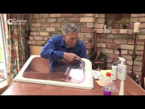

    I would seriously recommend that you use nothing but a polishing product specifically formulated to use on acrylic plastic windows.
    Using many other products including glass and metal polishes presents a risk of a time delayed chemical attack that can leave the window with a nasty, irrecoverable, rash of micro crazing. These appear as whole number of minute silver glints in the affected areas.
    What occurs is the chemicals used in those unsuitable polishes release the inevitable stresses locked up in the plastic from when the window was heat moulded. Alcohols and acetic acid which most metal and glass cleaners contain, along with other agents cause this.
    As said this is not something that happens shortly after doing the job, it is an insidious chemical attack taking typically several weeks into months to reveal its affect.
    Before saving a little of the price of buying the right stuff to safely do the job you best check what the replacement cost of these very expensive windows are before using anything else.
    See the late knowledgeable John Wickersham's videos on the subject:
    https://www.youtube.com/watch?v=ryT4vjyC-fM
    https://www.youtube.com/watch?v=N6q0qGu_14I

    Just watched the videos, one of them used Fenwicks product.....not sure which one I will try.
    Thanks again.

    Well, being a cheapskate, I tried Fenwicks and the result is brilliant.
    My wife could not find fault, the windows are sparkiling and all marks have gone.
