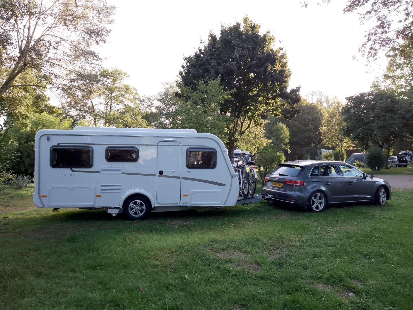

    This is what I'm towing, so you can see it is not really small.
    Colin

    Thanks for the photo. I went on the tow bar calculator website, it's really useful, it gave us all the information (and reassurance!) we needed, thanks so much for your help
