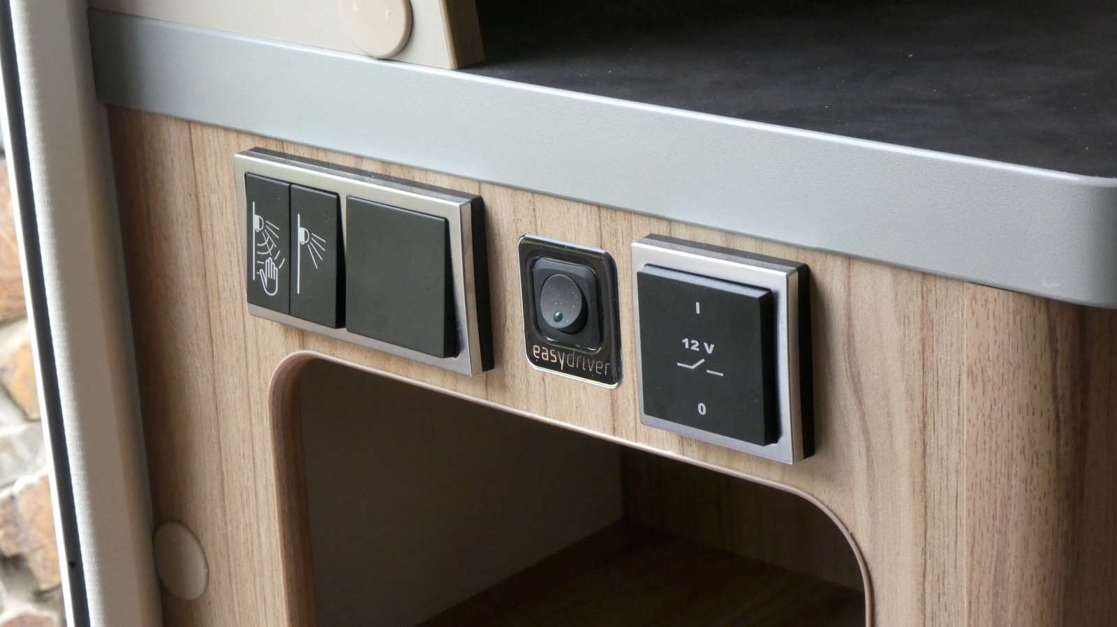

    In 2023 we bought a new van and had our second Reich mover fitted. I do find them a little jerky, but I'm being very
    critical. What they do offer is the option to get away with heavy cabling and a clunky on/off swich. We have one of these tiny switches just inside the caravan habitation door.
    Reich Easy Driver Isolation Switch | Reich Code: 227-2211K1K | Caravan Movers | Leisureshopdirect
    Colin
