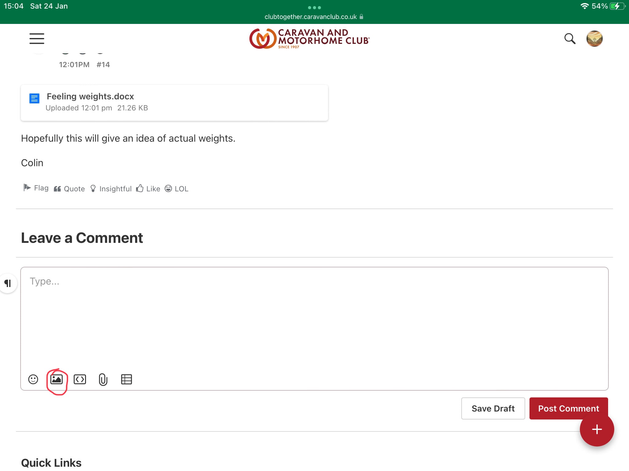

    @Mick re photos
    Look at the red lined box in which you post to reply. There is a little mountain icon in a box at the bottom. Click on this, and it should bring your phone photos up. Select the photo you want to post, it might say “use” at the top of the photo, (it does with an iPhone) click on this, and your photo should appear inside the reply box. Then press post comment. Don’t worry about the size at this stage, just try to post a photo.
    This is a photo from my screen telling which icon to use to post a photo….
    I have ringed the icon above you need to use. If it doesn’t work then come back to us with your phone make. Good luck.
