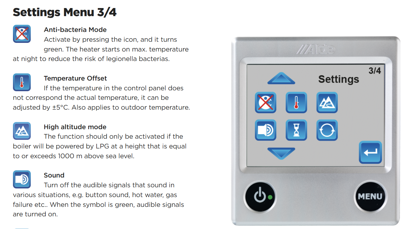

    Hello, I have the same van and heating. Check whether Anti bacteria mode is activated, and if so then deactivate it as when activated the heater goes onto max temperature when it starts. Also we dont have the hot water on in the van at night, it is set to come on when day mode starts and off when night mode starts.
    Settings guide at https://www.alde.co.uk/service-support/tips-and-advice/alde-control-panel-3020-he-settings-menu/
