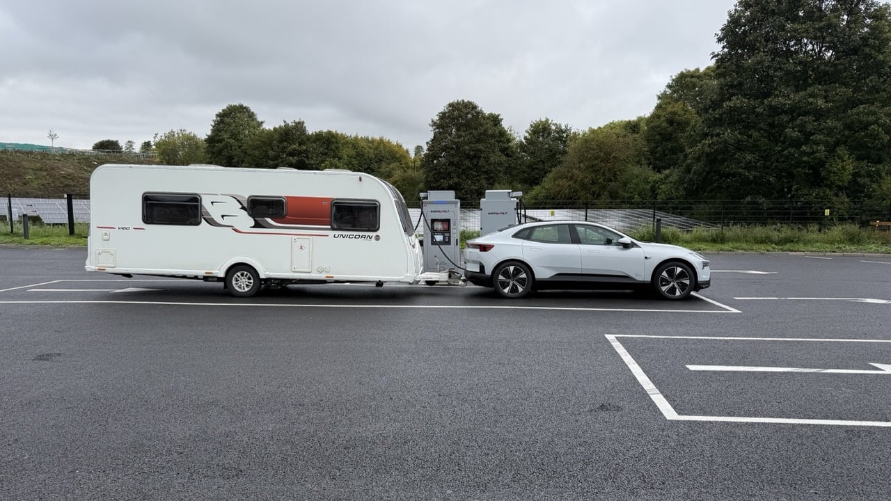

Having left home at 10:30, we pulled into the Instavolt Winchester hub at 12:11, 82 miles later, at 18% battery. Winchester has 4 pull through charging stations designed specifically for towing, so by 12:13 the charge had started. We both used the facilities, and I grabbed a coffee. 30 mins later, having added 70kWh of energy (an amazing average rate of 140kW - MUCH faster than the previous car), I stopped the charge and we got going again, having increased charge level to 82%.

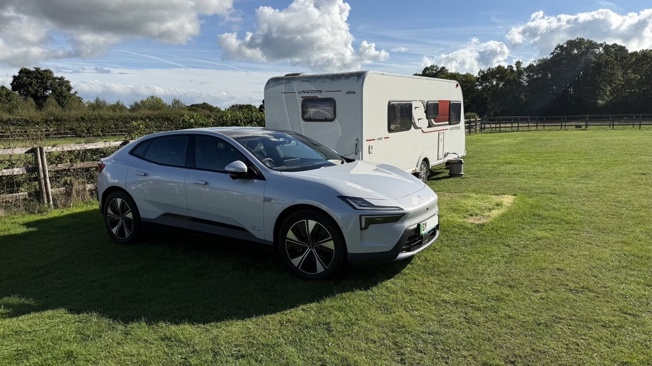

We pitched and had a great week. Danebury is a lovely CL with individual water as well as metered 16A hookup (10kWh included per night). It also has the possibility of using their 7kW car charger, though we opted not to.
