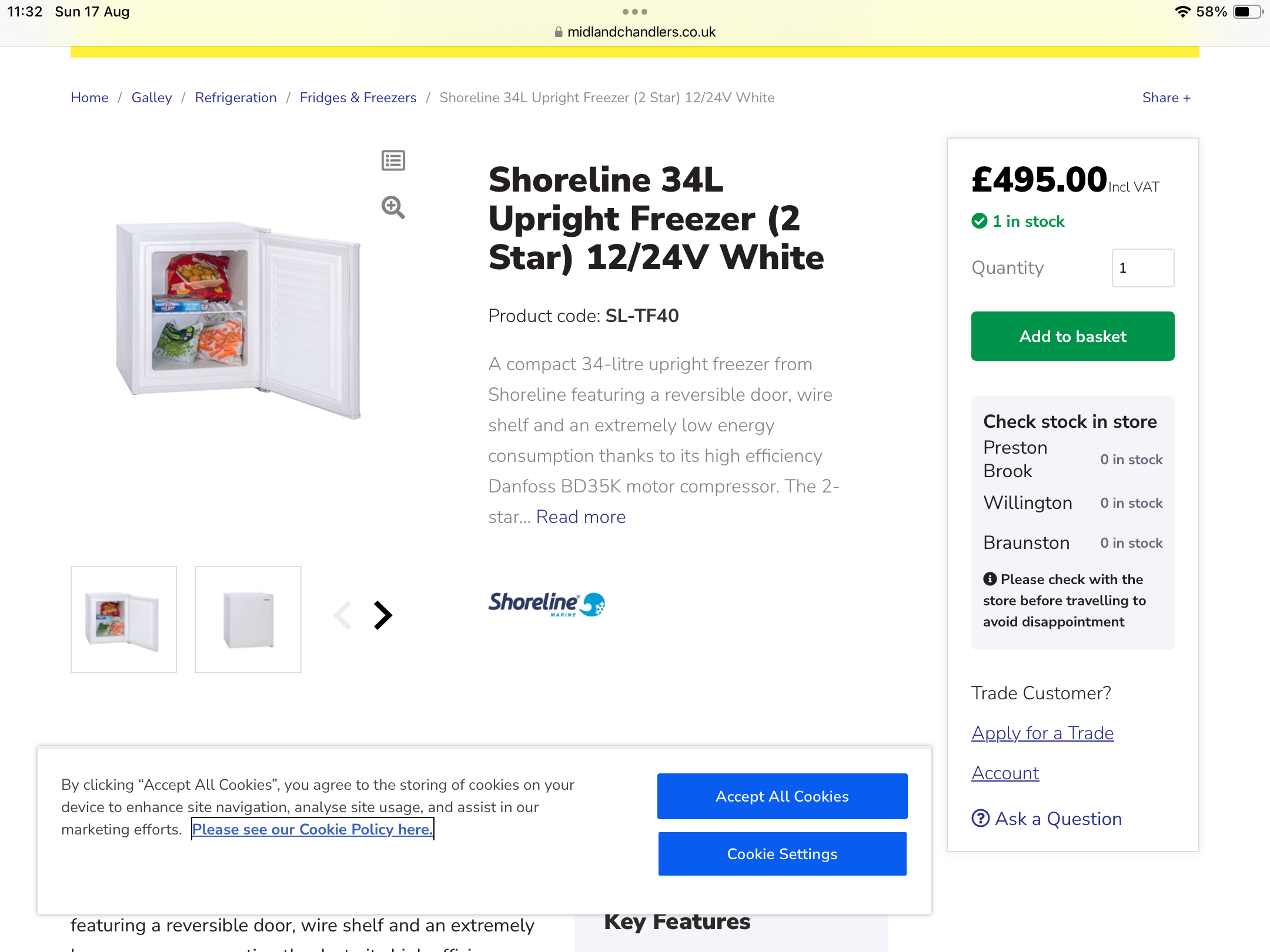

  • eurortraveller
    eurortraveller Club Member Posts: 7,285
    If you want freezer capacity for frozen dogfood for a fortnight then something like this one holding 34litres rather than a portable fridge feezer with limited freezer space.
