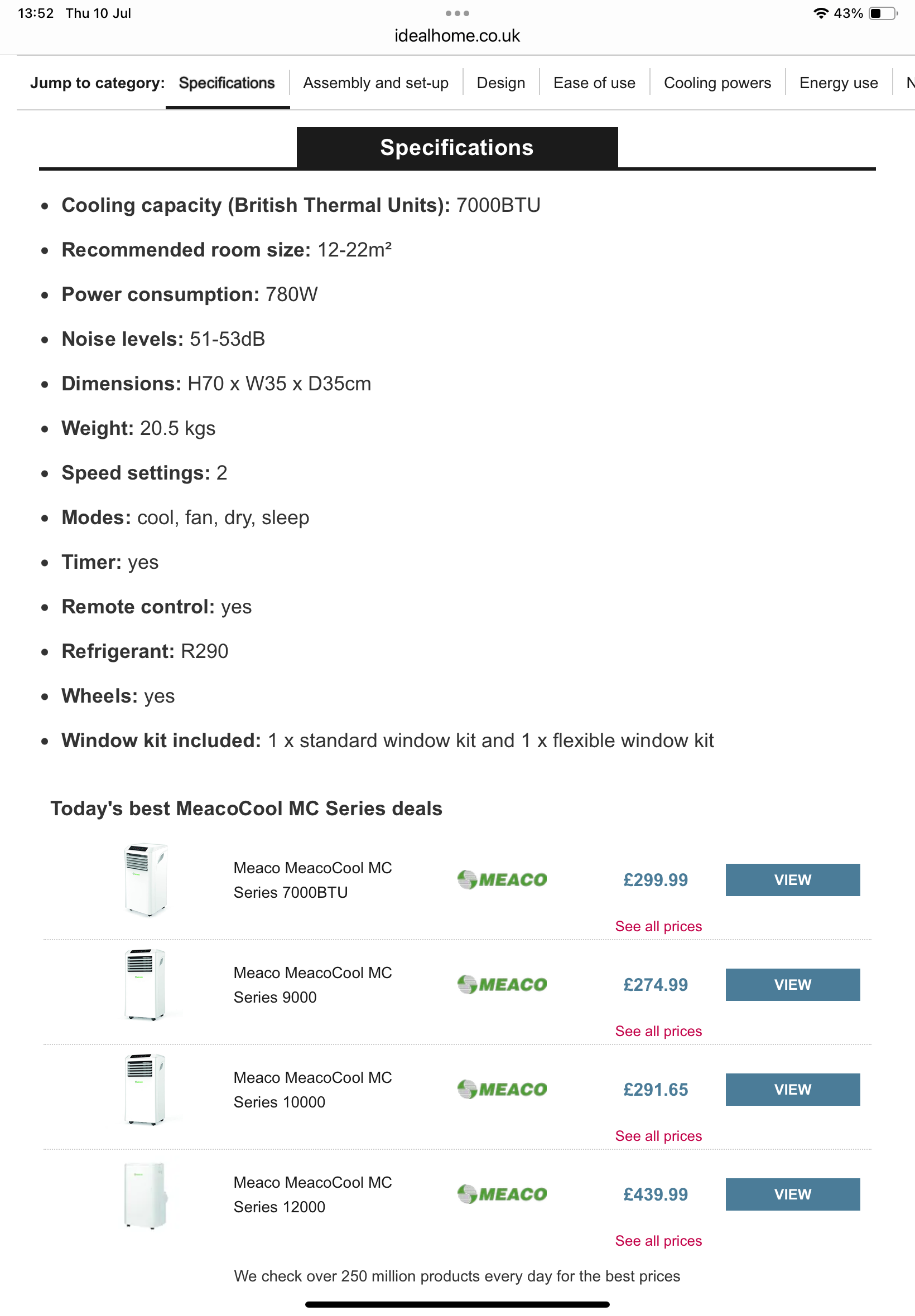

    OK peedee, you are not a fan of them, but surely they are man enough. This "small" unit, the cheapest John Lewis do is suitable for 12 to 22 square metres.
    Meaco 7000R PRO Air Conditioner, White

    What is the difference in ceiling height between an average house at 2.4m and a motorhome. I know on the small model I posted, just as a guide, the floor area should be OK for a caravan at 12+ metres. These domestic units must be a cost effective option for those who want air-con, even if you up-spec to the next size, just to be on the safe side.

    @eribaMotters I would be woried about power consumption, the one you listed says 780kW. That cannot be correct and surely must be an error in the listing?
    peedee
  • Tinwheeler
    Tinwheeler Forum Participant Trusted Posts: 24,158
    It looks like a typo. Try 780w.

    That seems rather low for an airconditioner but you are probably right. Nevertheless it still a draw of about 3.4 amps from site supplies.
