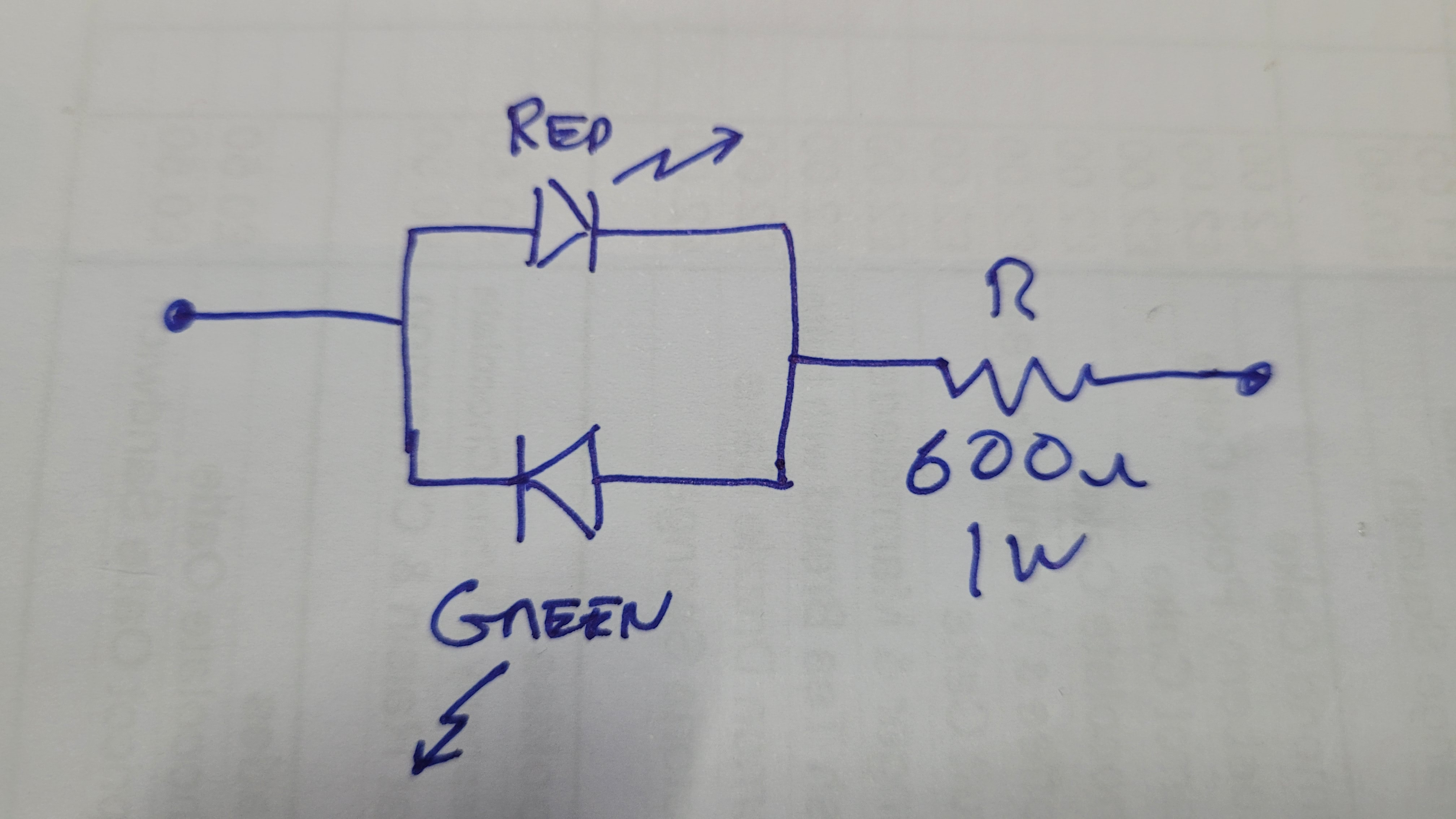

    Just be aware that standard LEDs are about 2V and need a dropper resistor to limit the current when used on 12V (13.8V). The dropper resistor may be built in to the ALKO unit but from memory I don't think that it is.
    I think that you need to find a Bi colour (Red/Green) 12v 5mm LED to use as a direct replacement. If you let me have a link to what you have bought, I can comment on their suitablitiy.
    I have had a browse for 12V Bi colour LEDs and, annoyingly, have drawn a blank.
    If you go down the dropper resistor route you will need about 600ohm (nearest normal value is 680ohm which would be fine) the power in these resistors would be about 1/4 watt so specify 1 watt devices to keep them cool.
    Photo is a sketch of the wiring for the Bi colour LEDs.
    I am on holiday until 12th July but I would be happy to assemble these when I return if it helps.
