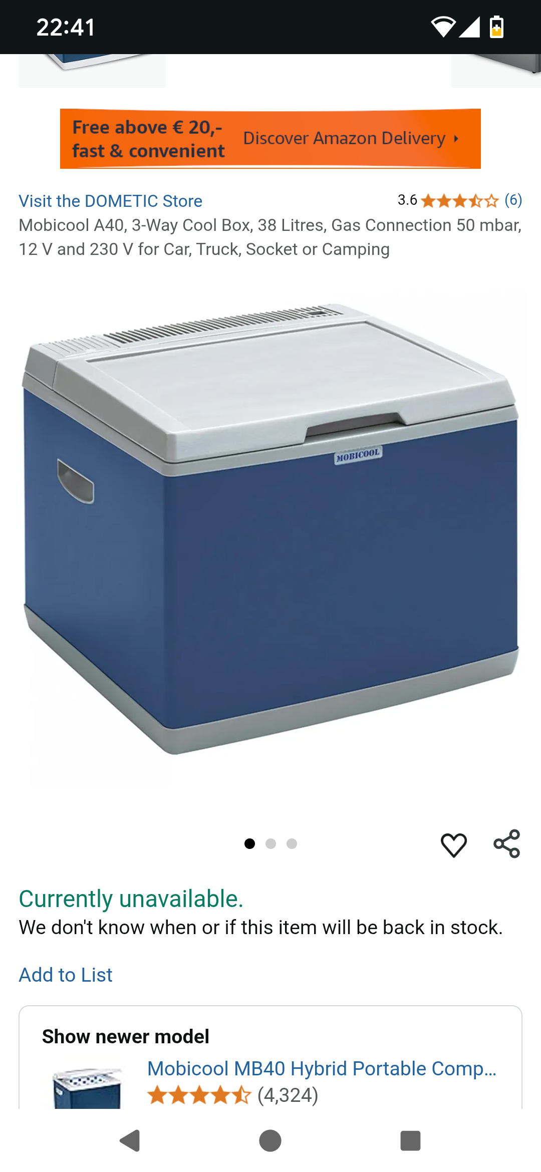

    I'm using a separate mobicool 3 way fridge not the one built in the caravan. Does this make any difference?
  • Tinwheeler
    Tinwheeler Forum Participant Trusted Posts: 24,247
    It’ll still flatten a 12v battery in no time at all.
  • Sharktale
    Sharktale Club Member Posts: 57
    First Comment Name Dropper
    Like this one

    Unless there is a problem with your caravan fridge, it would be much easier just to run it on gas. Those portable Dometic fridges are quite pricey too!
    We had to do that once, when the electric element failed while we were abroad, we have a largish Thetford fridge freezer, we found a 6kg gas bottle lasted about 14 days. On mains electricity the FF uses 4kWh per 24 hours.
    Running a portable one on battery, a fully charged 100AH battery will probably only give you 60-70 AH, so 10 hours on 6amps when you include everything else.
    A bigger solar panel would help, but why not use the equipment already fitted?
