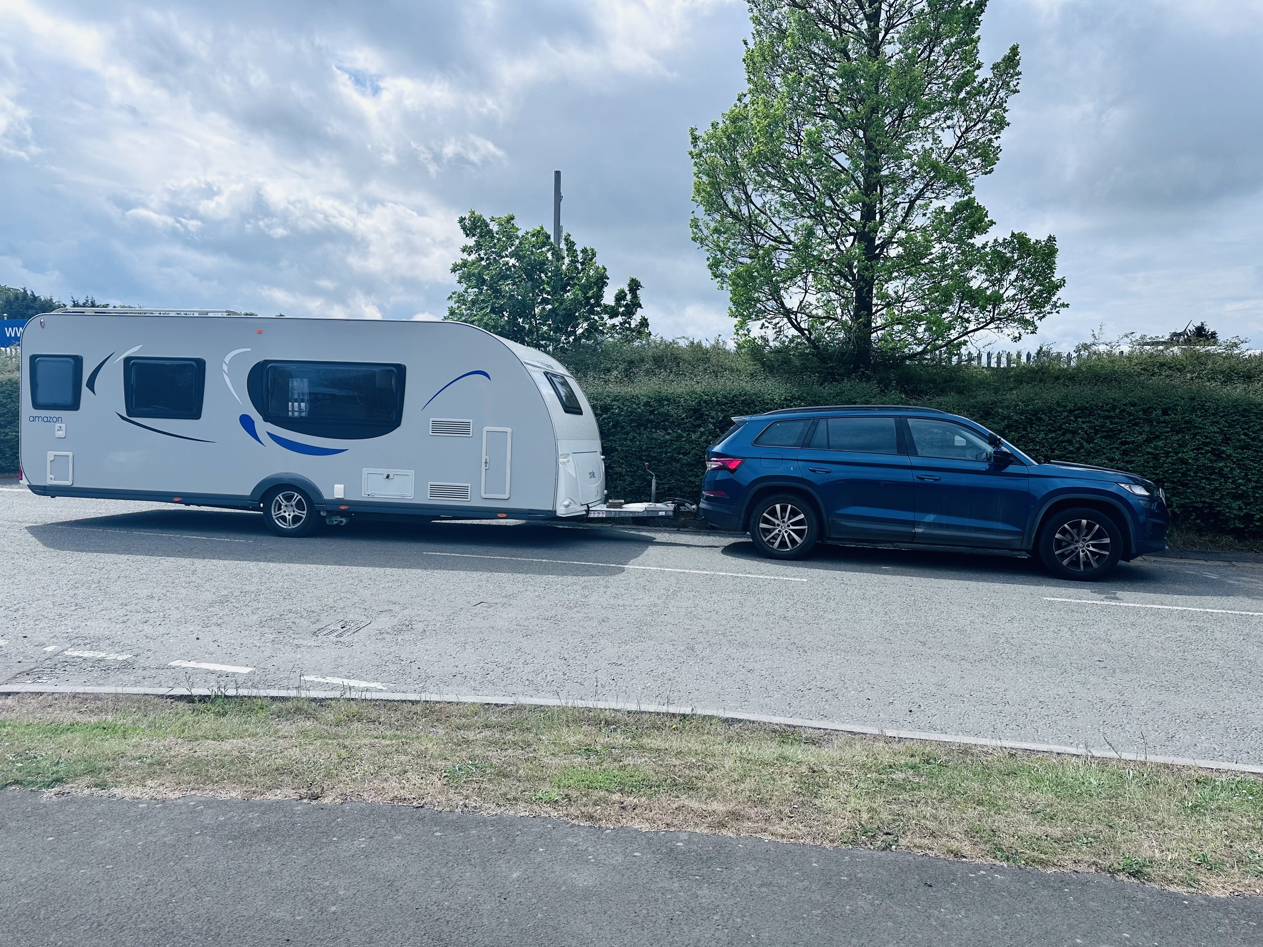

We've just got a new caravan and taken it out for the first time. I wasnt driving but found towing it an absolute nightmare. I felt like it was knocking about on the tow bar, jerking a bit. In my head it felt like it was going to start snaking about it did a bit of a shake very slightly side to side at one point. I was so bad I had to keep stopping due to a full on panic attack. I thought we might all die. Lorries passed a few times and it felt like it was getting sucked out of place and might lose control. The caravan is amazing and we were going to plan a full year going away at weekends but now this. Has anyone had this fear what is the answer? We've already ordered a new car with a big diesel engine as our set up was close to limits.

    I suspect your last sentence gives a huge clue and things will likely be a lot better with the new car. Make sure you are towing with the correct noseweight and the tyres on car and van are correctly inflated. These two factors alone could make the van unstable if they are not correct.

    Thank you I've spend the day googling it but not considered the tyres yet - the caravan is 21ft by 8ft and its a 1.5 petrol engine the stats and figures say it should be okay but it didn't feel like it

    It's the all up weight of the caravan (MTPLM) that needs to be considered, not its physical size. That weight needs to be within the towing remit of the car so that you do not exceed the car's gross train weight as shown on its weight plate. Towcar tyres usually need to be blown up a bit harder when towing - see the car handbook - and the van tyres as per the caravan handbook recommendation. As I said, you also need the noseweight to be correct.
    If you were towing the caravan empty, it could well be a bit skittish and could behave differently when loaded but do not exceed its MTPLM. Visit a weighbridge if you’re in doubt.

    What you need to look at are the weights involved. What is the kerb weight of the car and the maximum permitted weight of the caravan when fully loaded? And the model of caravan?
    Was the caravan loaded up, or empty?

    Thank you all very much I think all of this is the problem when looking at the set up the nose looks heavy its sort of down and the back of the car down but front of the car looks higher up - the kitchen is at the front. We used human scales as the weigh thing was out of stock. It must not have been accurate. The lucky thing is there is a weighbridge right next to our house. The caravan was loaded up but not with lots of stuff just bedding, few kitchen items, no food or anything, an awning on the axel

    You’ve demonstrated the exact reason for increasing rear tyre pressures of the car - check your handbook for guidance about towing.

    An indication of what car you are using to tow the caravan as well as the weight limits shown on its weight plate and the corresponding details for the caravan would help in making a better assessment of what might be the cause.

    I will stick with it as best I can. The car is a skoda kodiaq 1.5 petrol and caravan adria astella I think its over the 85% thing. It was suggested to try a tow car.info website and it came out as 1 star for weight and not a match. We are going to stick it on a seasonal site and have ordered a vw amarok - that gets 5 stars for everything as a match. We feel like we've been really stupid over the whole thing and with 2 little kids in the car too :(

    We don’t know the exact weights of your outfit but I suspect you have a mismatch of car and caravan. If that’s the case, there should be a vast improvement when you get your new car.

    There are a few different Astella models, do you know the maximum permitted weight of your one? I very much suspect that the caravan is much too heavy for your present vehicle. It will be a case of “the tail wagging the dog”.
    Our daughter has a new 1.5 litre petrol Kodiaq, I think the max towing weight for her one is around 1700kg, or even less, and towing at the max is not a good idea if you have never towed a caravan before. I took a quick look a few months back as they borrow our caravan and it would have been good if she could have towed it, but our van weighs in at 1900kg, so totally out of the question.
    We tow with a 3litre diesel VW Touareg, the new car you have ordered should be ideal.
    Meantime you need to reduce the weight as much as possible while still aiming for the correct nose weight. Remove the awning from the van as the first step.

    Thanks - this must be the case I think they are both around 1800kg therefore on the max - the van is about 1560 without anything in it we have a weighbridge near our house which will be useful. Im not risking pulling it again its going to have to wait for the new car. It did feel like the caravan was in charge of the car if that makes sense it was knocking on the tow bar I think its breaks might even have been coming on to cause a jerking sensation. When lorries were passing it was horrible. I nearly got a taxi home at one point We are going to have it checked over again by a different place and wait for new car and then practice a lot as well as getting the weight correct

    You don't say which Adria Astella, but if it's one of the larger models, it could even be over the towing limit for a Kodiaq 1.5.

    Cat23, it’s the max fully laden weight you need to consider - the Maximum Technically Permitted Laden Mass. It will be on the caravan's weight plate. If you exceed that, you will be breaking the law. You need to know for sure that when fully loaded you are below that weight. I'm afraid "about" the MTPLM isn’t good enough. It needs to be under the Max. Your estimate of 1800kg only allows you a payload of 120kg which is nothing and, if you have a mover fitted, it will use 30+kg of that payload.
    Sorry if I sound a bit harsh but I’m trying to keep you safe and legal. I'm more than ever convinced now that your caravan is a mis-match for your current car and think you’ll find a terrific difference with the new car. 👍🏻

    Of all the Astella models only the 644 is legal to be towed by anything with a GVW under 3500kg in the UK because all the others have a body length over 7m and they basically need a truck to tow such a long caravan legally. Besides, if you've got one with the kitchen at the front, as you say, it'll be a bigger one than the 644 because the 644 doesn't have the kitchen there. An Amarok won't make the combination legal as its GVW is too low. I'm afraid it sounds as though you've got yourself into a no-go situation.
