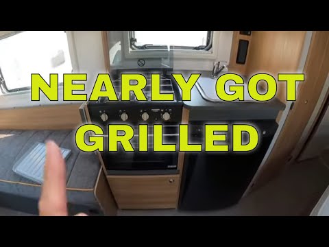

    Hi, i had the same issue with the grill not staying lit. There are loads of unhappy people with the issue. There is a youtube clip from a dealer and he said the tap/press the control button numerous times to clean a contact. It worked for me, i have a working grill that never stayed lit from new.
    https://m.youtube.com/watch?v=b9o7Ju9fcEE

    Edit. After pressing the control knob numerous times, ensure that you blow any excess gas from the grill enosure and give it 5 minutes before tryimg to light 💥
