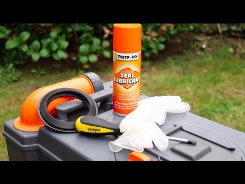

@ Muckyrob. You need to post the model number of your cassette/toilet. I have the Thetford C250 and just replaced the lip seal as it had slightly hardened over the years, but as far as I know for this cassette model there are no spacers, neither for the cassette or the bottom of the bowl.
0 -
I have found a useful video, see link below.
0 -
There is a very small gap between casette and the base of the bowl so that the casette can be extracted. Fluid could leak here if the blade is closed and liquid placed into the bowl. Closing the blade before the rinse has all drained is a likely culprit.
