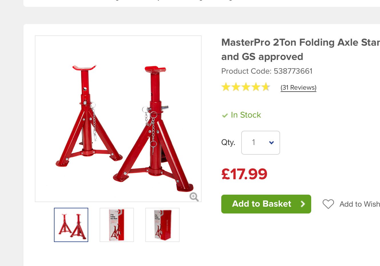

I am getting some caravan axle stands and was wondering what is the best place to put them under the caravan. I've attached a picture. Is it A, B or C.

    Just curious how do you find getting the axle stand underneath and pumping up. Just looked now and that is seriously tucked away underneath the caravan.
    Makes me wonder do I just purchase an al-ko jack kit and a scissor jack turn to turn wheels around every 2 weeks during winter instead of getting off the wheels permanently.

    Axle stands are height adjustable so can be set to allow for the slope if that’s what you want.
