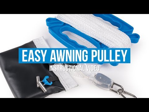

    Due to the weight issue, I carried out a small mod to the awning which assisted in pulling the awning through the rail.
    As the caravan has a more gradual slope from the front of the rail rather than the tight bend at the roof at the rear end of the van, we always loaded from the front.
    To assist with this, I fitted a brass eye in the flap that protrudes from the roof line of the awning. When loading into the rail, we attach a fairly long guy rope with a quick release hook attached. ( I have fitted these to all my guy ropes as it is easier to clip on) this enables the OH to ease the awning through the rail as I push it into the rail.
    If you need a translation of this garbles account, please ask.
  • ocsid
    ocsid Club Member Posts: 1,395
    1000 Comments
    edited May 2020 #13
    Kampa sell, or maybe that is "did sell" a pulley based contraption to haul the awning around the rail.
    This is not a recomendation, just an observation.
    https://www.youtube.com/watch?v=0LMycpwWzNs
    https://www.youtube.com/watch?v=yk1CBl7mQt8
