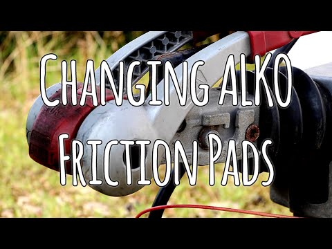

    Hi, I had the same question when I first started caravanning about 3 years ago. As all have said, likely culprit is dirty tow ball and stabiliser pads.
    I removed the pads and cleaned them up with a fine sandpaper and brake cleaner and then the creaking/groaning went away. The issue for me was that although I also removed the black paint from the new towball....I didn't do a thorough enough job and some of it still contaminated the pads.
    Here's a video showing you had to remove the pads assuming you have a similar stabiliser....really easy job to do...minimal DIY skills needed!
    https://www.youtube.com/watch?v=Hxssz8ukUFs
