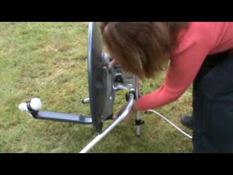

    Mine as the clip is even closer and specifically purchased because of that feature; the greater stability that configuration offers;
    https://www.youtube.com/watch?v=q6TFMqFI9OE
    It brings disadvantages in looking over near obstacles  like close by motorhomes, caravans to a lesser extent and hedging, though for trees a metre higher makes little impact.
    Here as a ready guide the beam can conveniently be considered coming down at an angle of one in two, so if you are twice as far away as something is high you are going to see the satellite over it.
    On club sites with their very close spacing it can be an issue seeing over a neighbour, but the club generally provide a viable digital terrestrial signal so the dish rarely gets deployed on club sites.
    I do feel the size etc of dishes used here in the UK has connotations of a status statement; a discrete 36 CM would often be suitable but one sees massive 80 CM white jobs on towering tripods proudly taking a big slice of an already modest pitch.
