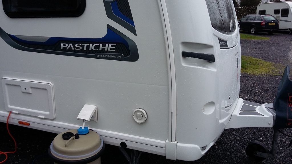

Took delivery of new coachman 565 end of feb and purchased new towing cover at a cost of £300 only to find no access to offside awning channel has anyone else had this problem?

    I spoke to the Coachman representatives at the Caravan Show   about this. They stated it was a lack of communication with the awning rail supplier which caused this design fault. Sorry this will not help you but Coachman say they will have a redesigned awning
    rail by this summer. I did ask one of the salesmen one of the awning suppliers stand about it and was told I could put a notch in the offside rail!!!

    There is another thread a way back discussing this problem on 2016 Coachman's.Noticed at the NEC that all Coachmans were "missing" the cut out in the offside awning rail, and the manufacturers reasons are frankly pretty poor.

     Vistited my local dealership today from where i purchased van from and checked coachman vans on sale and noted all pastiche & vip models have no access point But vision models have why?

    We have a 2016 Coachman VIP with no cut out on off side, I sugested cutting my own with a dremmil or such like which would be an easy fix but I was soon told 10 year guarantee would be invalidated.

    I asked at the Coachman stand at the NEC Oct show about this omition, reply; if you take your caravan back to the factory in Hull they will do the cut out at your expense. I e-mailed Coachman as I believe it is there error but I was amazed at ther response
    quote "The rail manufacturer & Coachman Caravans were not aware of the fitments of any aftermarket products that required the entry point" end quote.
