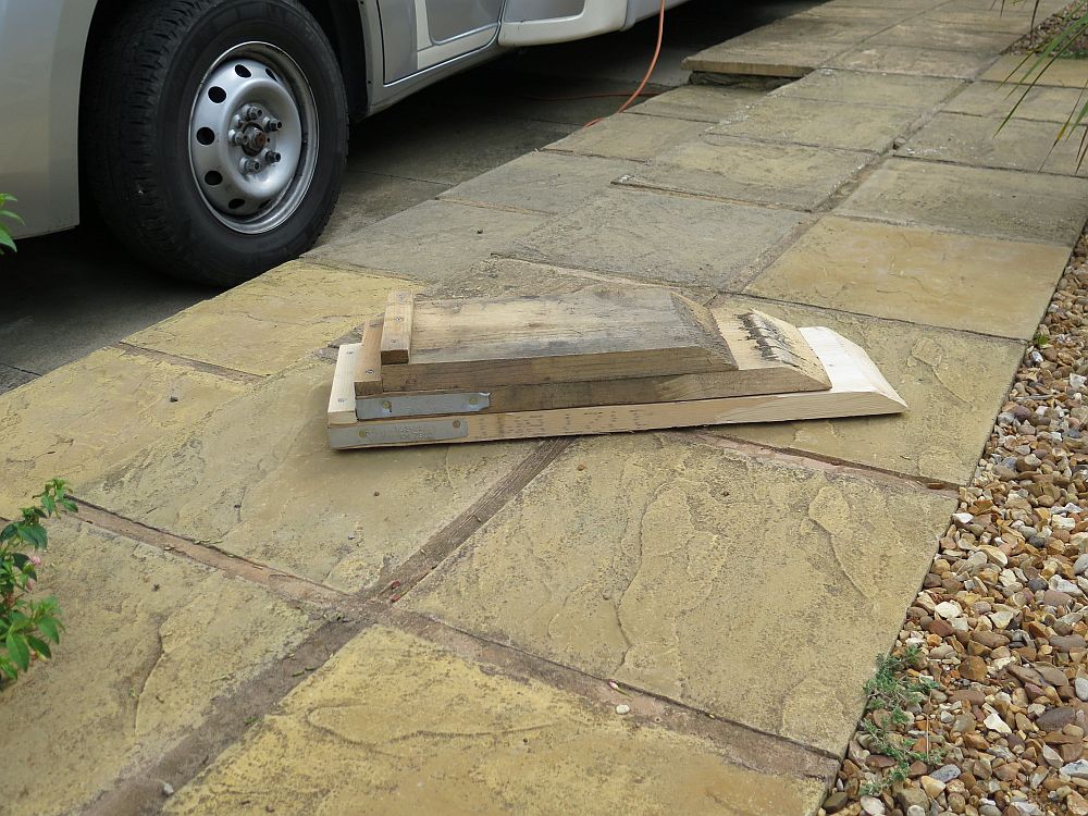

    I gave up on the sloping ramps and the three section ramps as I found them difficult to use effectively. I went to B&Q and got a couple of scaffold planks and cut them to size. I don't think they are more bulky and the beauty of them is the wheel is always
    on a flat surface. Might seem a bit Heath Robinson to some!

    I have some of these David, inherited from the caravan. May have to revert! Off to Italy for three weeks so will see how it goes.

    I use this system but yours are posh, they have a strip at the back for the tyre to rest againstSmile

    DK, the ones you made look good but are they bulky and heavy we don't have anywhere to store them in our van, the ones we have fit into the custom made bag and sit on the floor of the van between cab and habitation.

    Thats a good question. Having had both the Milenco and a Fiamma set in the van I would say no they don't take up more room but then we have underbed storage and they are immediately accessable from the side locker along with the electric lead. I am not sure
    we have used all three on one wheel yet but certainly two. I was never happy with using the sloping ones and the stepped ones I broke when I went off the end once. As I said the advantage on the planks is that the wheel is always on the level. Just a tip for
    anyone making their own. You have to have a slight step between each plank otherwise its difficult to get the wheels up onto them.

    Thanks DK, Phil has had a look and thinks they would fit ok in the bag that we have so he's going to have a go at making a set, do you have any measurements by any chance,Undecided
    I take it all 3 bits were able to be made out of 1 plank?

    Tammygirl, I have a similar arrangement. I suggest you make the first ramp as long as you can manage as it will be much easier to drive up. The height is not as much as a custom made ramp unfortunately. They worked well on my caravan but not perfect on the
    motorhome which of course is far more difficult to get perfectly level than a caravan.

    I think I got two of the shorter planks as that was the longest I could get in my Kia Venga!!! See
    Here
     I don't have the exact lengths but I would reckon the longer ones are about 30inches long and the shorter on about 15 inches but that is guesswork on my part. I will try and measure them tomorrow for you.
