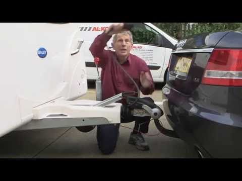

    According to Alko, the spring clip type breakaway cable is ONLY designed for looping back onto the cable and NOT for direct attachment to a mounting point.  It's not intended to withstand a 15KN straight pull (which is what the regs demand) and may fail
    before the handbrake is applied.  For attachment direct, a carabiner type breakaway cable is required.  They are available for under a fiver on popular online shopping sites.
    Why Alko have ever fitted the spring clip type as standard is a complete mystery as the carabiner type is equally good if looped back onto the cable!

    Alko have told us that the carabiner type of clip is too strong for around the ball fixing. As it seems that many people, for their own reasons, don't want to use the dedicated tow bar fixing point, then I imagine that Alko found themselves in a lose lose
    situation. And heaven help them if they encouraged van manufacturers to document using dedicated fixing points where possible - can you imagine the amount of legal advice that some purchasers would bury them under. In any event, Alko don't know if you have
    a dedicated fixing or not.
