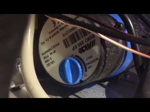

    I don't have one but I understand that on the heater somewhere there is a pump speed dial which should be set to 2 for normal use, may not have been set at PDI from the service setting of I think 5.

    If you have air in the system you get a fair bit of gurgling and banging. In our Bailey we had the problem after having the fluid changed. However, all the air migrated to the high point in the towel rail and could be easily released through the bleed valve.
    You will need more fluid to top it up though as the level will fall below minimum when you release the air. Don't know about coachman but our pump is on the side of the boiler under the front seat and the speed adjustment is fairly obvious on the top of it.

    Craig, the pump on your van is on the header tank in the larger of the two wardrobes and is a constant speed pump you do not have a variable speed pump which would be mounted on the side of the boiler. If the headr tank pump is too noisy for you, when you
    have corrected the current noise problem then a variable speed pump can be retrofitted but the pumps are about £90.

    We had same problem, the advice above to turn the pump speed down to no 2 worked for us.
    If the dial is not on side of the pump( a blue disc) then I wonder if it's electronic in the settings on the touchscreen
