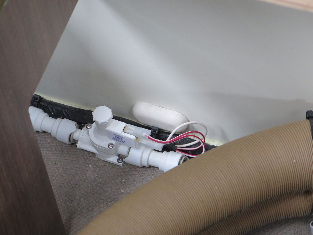

    In our last motorhome that happened on a regular basis. As CS suggests it is usually a pressure problem. I imagine you have a submersble pump in your onboard tank? The pressure swtch looks like the picture below.
    David
  • Cornersteady
    Cornersteady Club Member Posts: 15,507
    @DavidKlyne that's exactly the pressure switch and turning the circular knob on the top cured the problem. I'm pretty sure the instructions were in the manual and/or online. It involves turning it while having the taps either on or off till the pressure pump switched on/off. Not very helpful - sorry.

    You have microswitch taps, which means that you don't need a pressure switch. However nearly all taps supplied to the market have microswitches, but the caravan maker may decide not to use them, fitting a pressure switch is easier in construction because the wiring and time to connect microswitches is probably a bigger penalty in cost than the pressure switch cost. If you have a pressure switch it will almost certainly look like the one in the photo above. One point is that the water supply does not have to pass through it, although it is normally installed that way, it works just as well with one side blocked off and connected to a spur off the pumped water pipe 'T' style, and can be even cheaper to install like this, depending on the water pipe layout. If this is the case, then the cure is as above, twiddle the knob. They can be sensitive to the voltage supply, because the pump will have a higher pressure if the 12 v is up a bit, such as running from battery being charged by a mains connection, (13.8 v) or battery alone (12.5 v).

    My gut feeling is as mentioned above, you have a slightly out of optimum set pressure switch. (Somewhere in the system).
