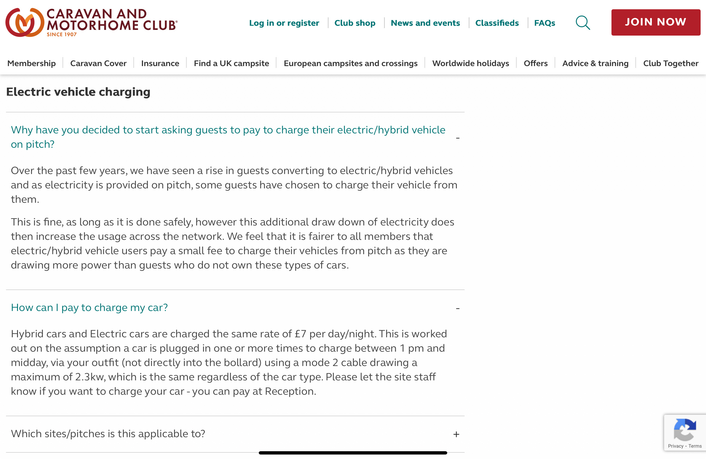

I don’t know what sites you asked at but CAMC has a very clear policy. Note, you must charge via your caravan, not direct from the bollard and a fee applies which wardens should be aware of. On a CL, it is up to the site owner to decide and apply his own terms.

If you charge via your caravan the circuit breakers in your van will protect the electrics and you won’t be able to harm anything which is one reason camc stipulate that method. The worst that can happen is that just your supply will trip out and I’m confident it won’t as long as you remember your total draw can only be 16amps. You won’t harm the site electrics at all because your circuit will be protected and isolated from the rest of the site. It’ll be a slow charge though.
Show the wardens that link if they still don’t know what it’s all about.

@Amesford charging via the caravan is still the way to do it as per my link above and the cost is £7. This is currently shown in the FAQ.
